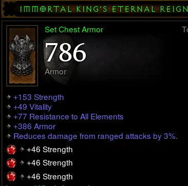

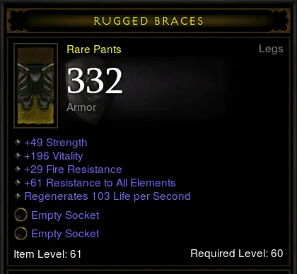

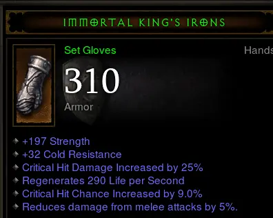

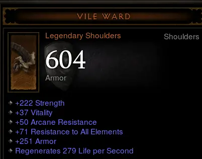

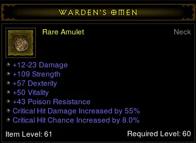

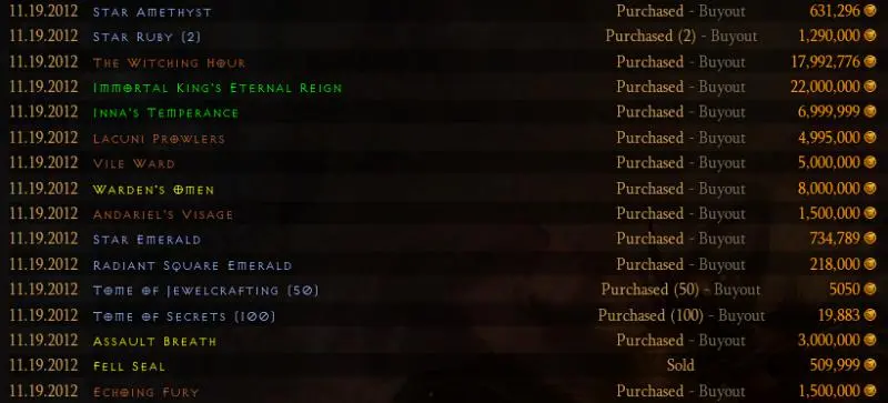

Point me in the right direction price wise and stat wise.

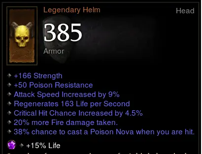

1) never ever buy a andariels with more then 10% fire damage taken. if you dont want a socketed andariels because of exp buy one with vit. way cheaper.

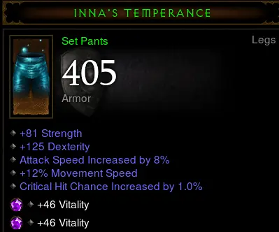

2) inna's pants with high strength is ok when other items are perfect, but better choose rare with str/vit (lower str, higher vit), all res, sox
3) the ammy is missing allres, i think you paid too much for it.
4) always search longer, maybe in the morning. don't buy everything within 1 hours. get 2 or 3 items. make a break. think of it. continue later.
5) witching hour: it's ok, but NO allres and NO life leech. prefer a rare belt with str/vit/allres/leech
6) always check if there is high res AND another res like fire/arcane. most of the time these item's arent that more expensive compared to items with just all-res.
7) IK gloves... *hm* better get str/allres/ias/crit stuff
8) never forget pickup range, easiest way via shoulders, gloves
All together you didn't make really "bad" choices, it was just all together, missing some stuff here and there... and then it's looking like *ouch* when you're done.
Don't worry, your next 40-50M will get you back to the right road. Just try to get some of the stuff sold again for same price

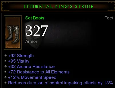

Looks like you have 36% movement speed but the cap is 25%. Switch one of those movement speed pieces out for something with better stats.

Buy a Ik helm, sell Inna pants and get a rare pant with AR and more vit than str on it. Run speed cap is at 25%!!
Get a rare shoulder with Life %, Vit, and Pick up radius on it. Buy a solid echoing at 1K+ dps with socket and crit dmg if you really can/want. The OH is good!

Also I bought IK helm and sold Andy's for 200k more.
Trying to sell Inna for the price I paid, which seems Is the ball park area for all other replica's that match it.

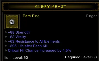

Paid 500k for these, did I do good??

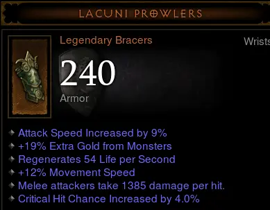

I'd replace the lacunis ~80str/80vit ones for like 1M.
Saves you some money for a good MH.

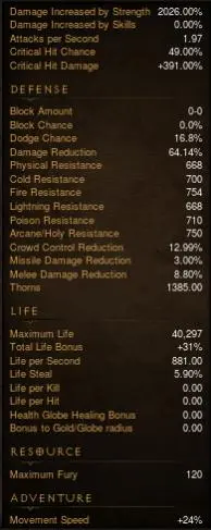

Well I've made some adjustments to my barb:
No longer at 100k DPS..
85k now but!
I have 5.90 Life Steal
0 LoH Still
391% CD
1.97% AS
Replaced IK Helm -> Mempo of Twilight, The Witching Hour -> 3% LS, Str, Vit, Life %, rare belt.
Replaced both my rings that made very little marginal DPS increase.. but.. 75 Res on both of them, one has AS + CHC other has CHC + CD, both have average dmg with Str, Vit.

Wile Ward -> High Vit, Str, Life%, Life regen, High Res, Radius +10 (Something affordable, maybe this is a bit extreme with my current funds)
