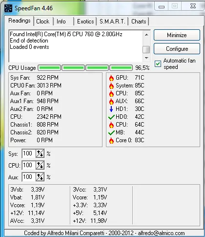

Diablo's 5 - i5 CPU - 99 degrees Celsius .. OMG Pic inside!

Are you using stock intel cooler? Those things are absolute garbage. Get this Arctic Cooling Freezer 13 Pro CPU Heatsink Cooler for Intel and AMD 1156/1366 AM2/AM3 W/ 120MM Fan - Arctic Cooling - Freezer13Pro from your most convenient website or local store. They are very cheap and do very well with Cooling. I have two of these in both my bot computers. my cpu's never go above 70 while botting 7-10 accounts with cpu's under very heavy load. You don't need anything fancy or expensive. This should do the trick for you and it's amazingly easy to install. The Evo 212's are also good for the same price range but you will have a better experience with the Freezer 13 when it comes to ease of installation and removal. I have two EVO 212's sitting in my shelves and I refuse to ever work with those again.
Don't forget to remove the thermal paste from the processor. Use an appropriate liquid to remove it. I usually use a flint less Q tip to soften the thermal paste and then use a piece of tissue to wipe most of it off and then finish cleaning it with the same liquid until the cpu is spotless. Let it dry for about 15 minutes and then install the heat sink. The freezer 13 and many other heat sinks come with thermal paste pre installed so keep an eye out for that. If you decide to add thermal paste yourself just put a grain of rice worth of thermal paste in the dead center of the processor and then install heat sink, Easy stuff, just be very careful not to bend pins or apply too much liquid when cleaning. Your Lian Li should also have no problem installing this cooler.

yours is much better than mine. I have the i5 760 skt 1156..

That will work but I would consider the fact that you don't need to spend more than 35$ to get much better temperatures. I guarantee if you get a 30-35 dollar heat sink you will be very pleased with it and glad you didn't spend a penny more. I always keep in mind price vs performance and if 15-20 dollars isn't going to make much of a difference then why bother? The one I recommended is the one I vouch because I use two of them and I am very happy with them. I also run 8 - 10 bots at a time and temps stay at around 68 stable.

Tomorrow i have it.. I took the side cover .. and could decrease by 10 ? C.. the air was not circulating ..
The stock intel heatsink is junk. Thats most likely your problem. Plus they use terrible thermal paste thats pre-applied on your heatsink. Its junk. You can spend 80 bucks and get an awesome one or 110~ and get enclosed water cooling.
