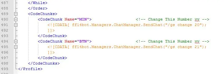

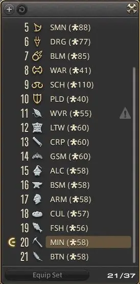

  1. First, open your character in game and open your gear set screen. Write down what numbers your gear set is for Miner and Botany.
    In my example Miner is 20, Botany is 21

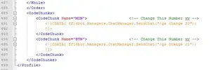

  2. Then, you download the xml files and open them up for editing. You can edit it in notepad but Notepad++ organizes things a bit better.
  3. Scroll all the way to the bottom of the profile and change the numbers to match your numbers that you pulled in step 1.
    		<CodeChunk Name="MIN">                      <!-- Change This Number vv -->
    			<![CDATA[ ff14bot.Managers.ChatManager.SendChat("/gs change XX");
    		</CodeChunk>
    XX is the number you would put in for your Miner class. If it's slot 1-9 make sure to put a 0 before it, like 02.
  4. Save the files and then run it. It should work great.
